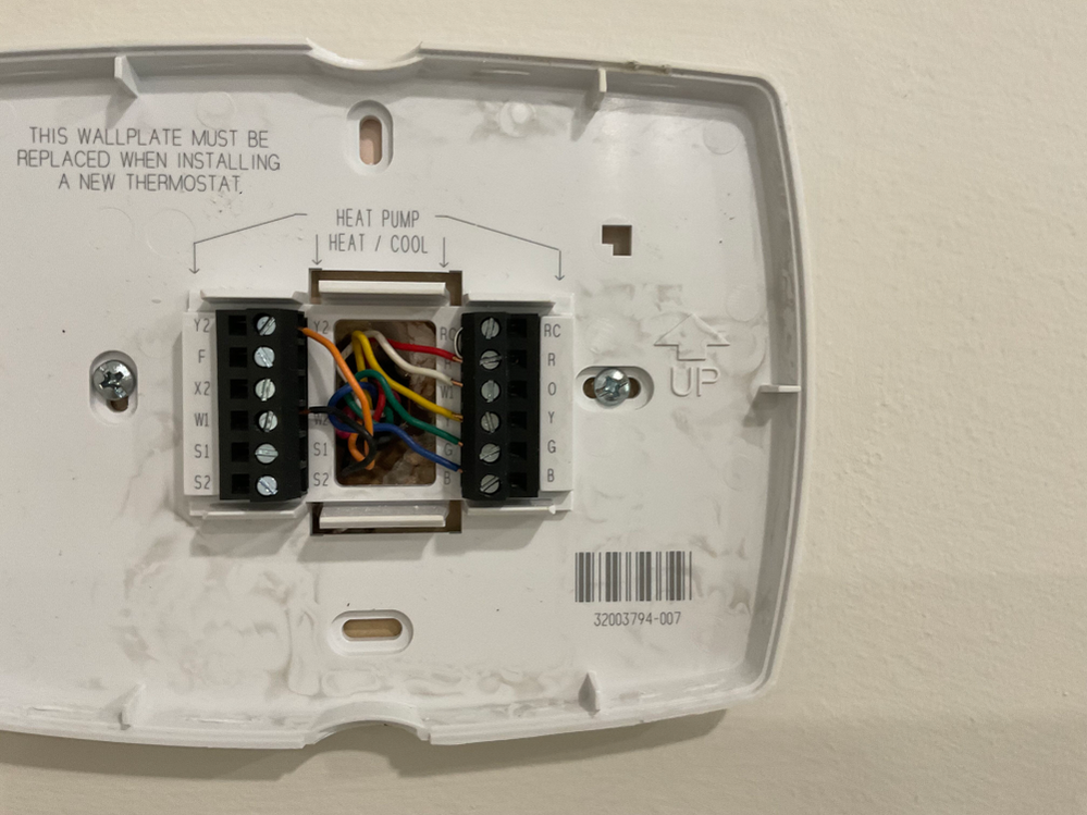

Youngho_J
There is no C wire on my system and I'm not sure it is compatible.
The thermostat model is TCONT803AS32DA Touch Screen with Dehumidification Control Comfort Controls
Houptee
B is your common wire, Trane calls it B instead of C.
Using the inner terminals markings on old Tstat  hook up the Nest the same way but with Blue wire to Nest C.
You lose the functionality of the dehumidification as that is a proprietary Trane thermostat for that system but it wont really effect anything it will still work  the AC normally and AC removes humidity that is how it makes you feel comfortable.

Im glad to hear that the system is compatible. Is there any plan for the dehumidifier integration in the future?
The tstat you have was made to work with that Trane system so it runs the AC on low speed if it senses humidity is high.
Possibly the * terminal could be programmed by a Nest Pro installer to activate the system but you would need to pay for them to come out and custom modify the Nest. They have a Pro password that gives them more ability to change the programming of the wire terminals.
I would try it without dehumidification and if you are not happy go the Pro route or reinstall the original T stat.
Your current thermostat doesn't appear to be wired to control a dehumidifier.
Try this wiring,
Orange - Y2 to Y2
Black - W2 to W2
Red - R to Rc (Jumper to RC not needed)
White - W1 to W1
Yellow - Y to Y1
Green - G to G
Blue - B to C
The * terminal is used to control a Humidifier or a Dehumidifier, and you would configure the * terminal during setup. THe wiring would depend on what type of dehumidifier you have, built-in or stand-alone.

I'll install the nest and see how it performs.  I also noticed that the dehumidifier was turned off anyway.
Thank you very much for the information!

Some of the Trane high efficiency units have a built in dehumidifier setting that runs the system on ac but with low fan speed. So it doesn't have a wire to activate it. There are several switches on the control board in the unit to configure the system and the proprietary thermostat from trane controls it. If you Google your trane model number you will find more information about it. I saw several discussions on HVAC-talk.com about the trane custom settings on the control board.

Youngho_J
I’m happy to report that everything is in working order.   Thank you very much for your help!
