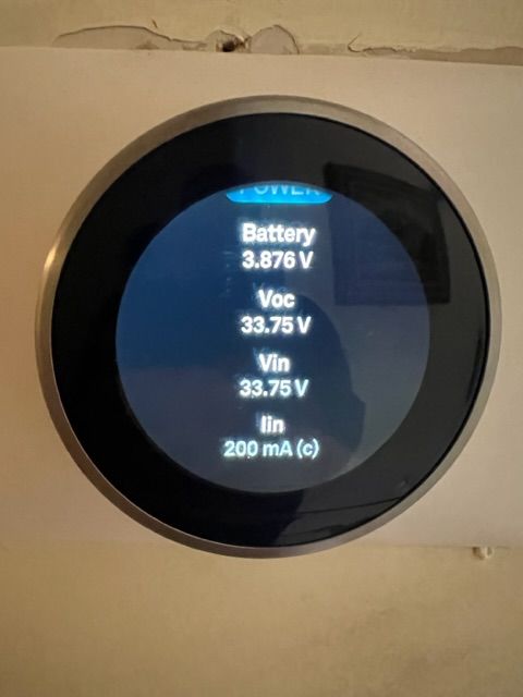

@Gadget63 , go to your Nest Thermostat and go to SETTINGS > TECHNICAL INFO > POWER. Get a screen shot so we can see the power status. It will look like this :
