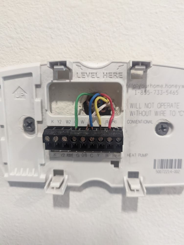

Hi, I'm having trouble getting the cooling to work, the fan turns on but the air isn't cold. The old thermostat works just fine. I tried setting the nest to the heat pump in case that might work but it does not.
note: there is an unused brown wire

Just to double-check, are you using a conventional, forced air HVAC system? If so, are you able to verify if both the fan and heating still function properly? If both work, you may be able to try wire swapping to see if another terminal can activate the compressor. However, before you do so, I'd recommend that you reach out to Nest Support first, just so they can assist you in doing so in real time.

Hi Jeran, thank you for the reply. I have tested the heating and that does not work either. This system is a conventional forced air system although I'm not sure if heating is gas or electric.
I think I will hire a recommended installer from Google/Nest.
 Edit: the fan does work

No problem at all! I think it may be wise to have a Nest Pro come look at it in this case, since neither the heating nor cooling are working. I'll leave the thread open if you have any more questions, or if you want to update the thread to see what the solution was.

Turns out I do have a heat pump but the tech couldn't get the Nest thermostat doesn't work. He said the nest learning thermostat might be work, but I'm not going to try that as I spend too much time and money on this. I'm just going to use the old thermostat and consider this close.
