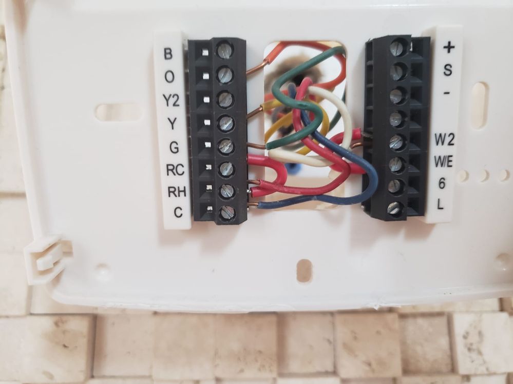

@ArashS , please post the picture of your old thermostat showing the wires attached before you started disconnecting them.  All heat pumps are manufactured in of two default modes.  The O models and the B models. O models default to cooling and B models default to Heating. Most heat pumps are O models. The original concept was that the models would typically be sold in the north where they need to eat more than I need cooling, and all models will be sold in the south where they need cooling a lot more than I need heating. By default the nest thermostat when it finds a heat pump configuration, will ask you what type it is, and if you do not know, it will simply default to an 00 and then, when you run the system test, you will know if you need to change.

Thank you for replying to this post. Here are photos:

@ArashS for a heat pump like you have, the white wire must be placed in W2/Aux. After that put the display back on and choose SETTINGS > EQUIPMENT > at this point you will see the backplate and the wires detected by the Nest.  Select CONTINUE and CONTINUE and then HEAT PUMP. Here you will see the O and B and one has checkmark ✔️ in front of it.  Just select the other one and press the display and move the checkmark ✔️.  So if the checkmark is on O,  move it to B, if it is on B, move it to O.
Now select DONE. And test your cooling.  You should have cold air now.

@ArashS, let’s go ahead and place your thermostat into the pro set up mode. On the nest display Goto SETTINGS > EQUIPMENT > CONTINUE > CONTINUE > PRO SETUP > CONTINUE. At this point you will see the nest backplate show which wires are attached.  The wedges will be green if OK and Yellow if it needs defined.  Rotate the ring to any yellow wedge.  Select and define it function. Go check and tell what wedges are Yellow. You have wires in Rc, Y1, G, OB, W2, and C.

@ArashS , One of the things we recommend for heat pumps is to put the R wire in Rc. In the picture you originally posted the red wire was in Rc. Why was it changed to Rh?  I would like to confirm that you changed the Heat Pump Equipment type from O to B or B to O.  And saved the Change.  If the mode is backwards, and you put the system on Heat, the heat mode will blow cold air.   If you get heat on both you likely have a problem with your reversing valve.

@ArashS , ok sometimes we find that the customer did not fully insert the wires into the nest backplate.  When a wire is fort inserted, the first contact point is used to detect a wire is inserted, then you push the wire farther in to reach the control contact point. Note the pictures below showing a Common wire inserted just enough to signal it is inserted yet not far enough to reach the control contact.
