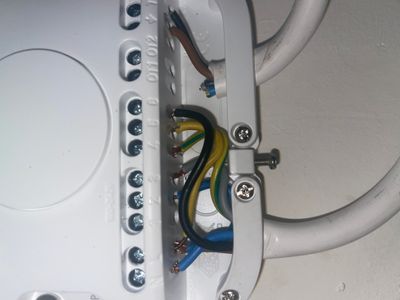

Can you upload a pic of the heat link connections?
just to let you know that the green is steady now and how can I send you a picture? The link option doesn’t allow me to do so.
mmmmm!!! What is the cable in term 4?
Where does that go, it's not an earth is it???
 I haven’t got a clue mate😂😂
You should be able to upload on the insert photo?
One other thing, when you press the heat link button, do you get 3 green lights?
Then, when the button is pressed, and the 3 lights are on, what does the neon show on the terms 1&3 - 4&6
I did upload one now can you see that? When turn on manually all the 3 lights are on and at the same Tom 1 is dim, 3 is bright, 4 is dim and 6 is bright.

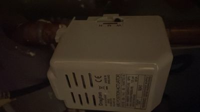

Do you have electromagnetic valves in ur system ? if so, can u check if those turn on? u should hear a click and see their light turning on if they work as intended
Ellsy66
Do you mean the zone valves, they're not electromagnetic I don't think. Just motorised and go from Auto to Manual Open
I have just notice the wire that seems to have snapped off from the block though (circled) I'm assuming that needs to go back in???
bbbiby
Probably yes, that wire doesn`t look ok out there.
The valve i was talking about looks like: https://www.ephcontrols.com/wp-content/uploads/2017/07/V221P.jpg for me. They should turn on (light and a sound) whenever heating is turned on.
 changed this one and all sorted 🥴

Thanks for the reply but the issue is now sorted. It was a faulty zone valve on the boiler that failed after a power cut. Nest was was talking to boiler and all okay. Only got sorted today however ❄️🥶
