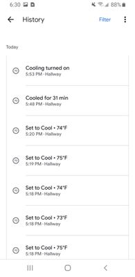

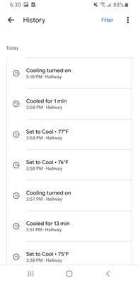

As you can see on the attached screenshots the equipment starts sometimes as short as every 5 minutes! I am afraid this will ruin the compressor on my new unit.
