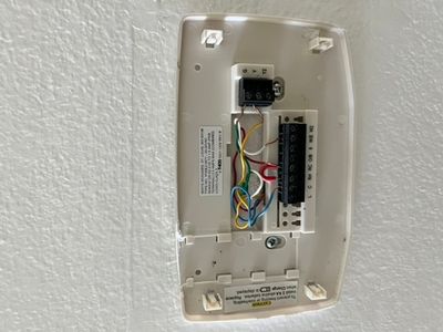

Is this wiring compatible with nest thermostat what can do with jumper wire please reply thanks  
9 REPLIES 9
TPOW
It's too blury to make any assessment
You're gonna need to take a better picture that shows clearly what you have.

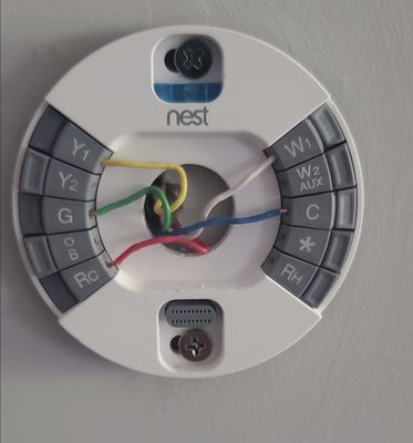

 is this fine
TPOW
Yes, so this is a 5 wire set up & is compatible,  usually, red & blue are your incoming power, green is fan, yellow is cool, white is heat, see my pic for proper connection

 is this fine
TPOW
The jumper is not needed
