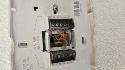

Hi it told me to check here I have  a trane heat pump set and trying to install our nest is there any ideas before I mess with it
It was a bad picture that wire is actually white I don't have a green the one on the G is black

This looks like you have a heat pump, is that the case?
Yes I have a trane heat pump
I think I have the wire configuration figured I just wanna make sure my B goes the C side on my nest  I've done some I just don't wanna mess up my system
Yes the B wire is the Common. The green wire on W1 is the Auxiliary Heat.
