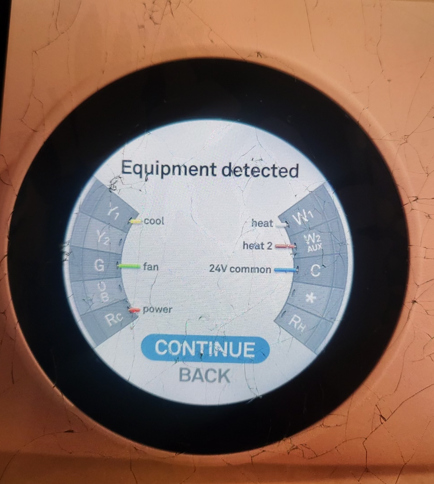

@hulumaxflix, we appreciate you providing more details. Big help! Incorrect wiring configuration could cause odd HVAC system behaviors. In addition to what was asked above, the wiring diagram on your thermostat display appears to be different. Can you pull your thermostat display and take a photo of its actual wiring set up?

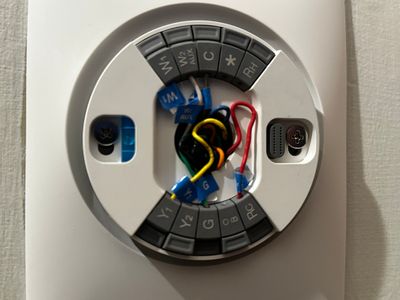

Thank you Mark and Zoe. Please see the requested image attached
11-28-2023 06:47 AM
Hi hulumaxflix,
Thanks for keeping us in the loop. Please move the blue wire to the O/B terminal and connect the black/brown wire to the C terminal for your 24V common. Once done, make sure to confirm the wiring changes prompt that will appear on the screen. If none, press and hold the button or the screen for 10 seconds until it shuts down to refresh. Then, activate your HVAC system.
