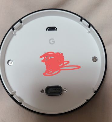

I have a newer nest so they seem to have gotten rid of the micro USB charging. I don't see a reset button anywhere as well and I think the only actual way to reset it is thru the display menu which is my problem altogether. I can hear and feel myself scrolling thru the menu items from the small touch area to the right of the unit though
Mine is the newest Learning 3rd Gen but I know the older ones have a charging port too. Pull it off the wall and look at the back. My USB port is right above the "G".
To reset it, I press in on the screen until I clicks and hold for 10 seconds. The tiny LED at the top of the screen blinks while it's rebooting.

Yea mine is strictly battery in the back no USB port. Also no clicking functionality. I don't know if they wanted it more minimalistic overall but seems to be a downgrade from other versions of the nest tstat
Well, if it's still under warranty, time to contact Google support for a replacement. Or buy a new one if it's not.

Sounds like a defective screen, if it's otherwise responding via WiFi and controlling the furnace via the app.
You might try resetting it by pressing in on the screen and holding for 10 seconds to see if it will reboot.
I don't suspect low battery or low power if it's connecting via WiFi.  But I guess you could try charging it for a couple hours with a phone charger.  Uses a standard micro-USB cable into the back of the unit.
