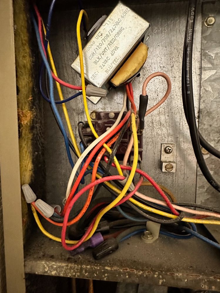

@Patrick_Caezza  I am replying for my mom. We replaced an old climatol thermostat. It was both heating and cooling. The blue wire looks to be Y/C?
Kl08
@Patrick_Caezza  Here is the wiring. Assuming we need a common but not sure where it would go since we can’t see a terminal block E158096C-3331-443C-BF17-F87973BB9364.jpeg5979CB5E-B2EC-464A-A5AD-8C323B3AEA52.jpeg381CDABB-BA7D-4898-9609-61062D6D338E.jpeg
@Kl08
In that case, you will want to connect the blue wire to the Y1/Y terminal on the thermostat.
I would also strongly recommend that you install a C wire. If there is an unused wire in the thermostat cable, you can use it or the Google Nest Power Connector.
