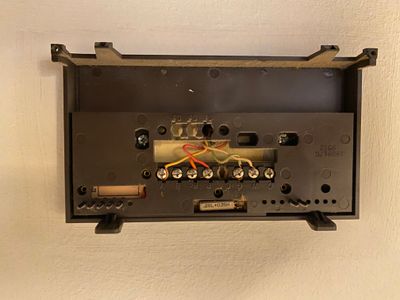

My existing thermostat has wires in W, G, R, Rc and Y. I want to connect W to W1. G to G. Y to Y1. Rc to Rc. I’m not sure if it’s ok to connect R to Rh.

Post a picture of the original thermostat's wiring here
You should be alright connecting the orange R wire to the Rh terminal on the Nest.
The wire on R is red. It’s still ok to connect to Rh?
Yes, it is, it looks orange on my monitor.
