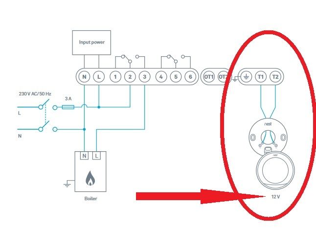

Can I power a nest thermostat directly from a 3 or 5 amp fused spur and then have it communicate via wifi to the heat link ?

Yes , but after some research I realised that the display needs a 12v DC supply.
I’ve seen on other threads that people have powered their display with a 12v dc driver/transformer and then the display and heat link will talk to each other wirelessly.
Will this be ok ?
Qwerk
Obviously the heat link will have a separate 240v input
That's why I asked the question, as the display is 12v!
You would not believe how many thermostats I have repaired after 240v has been connected to the display directly.
Simple answer, yes you can.
The base plate has a USB connection where you can also connect with a charger, like a phone charger. 240v needs to be stepped down to 12v, and that can be done with a transformer. Fuse at the spur as low as possible 1A or lower if possible. Linking from display to H/L can then be done WiFi.
No research to be done, the instruction manual shows the correct connections.

Understood. If you don't want your thermostat to be wired, you can try to buy a Nest stand for it. You can follow this link to check the Nest stand: https://goo.gle/2RB67vs. The stand contains a USB cable that needs to be plugged into your thermostat base and it will give the necessary power.
UanaC
Hello there! Thanks for posting. For the fuse that's connected to your Heat Link you'll need to use the one that has 3 amp. You can find more about this in the installation guide. Here's the link for the installation guide: https://goo.gle/2pTMYLC.

What about to power the display if I didn’t want to run a cable from the heat link to the display with the T1 T2 terminals ?
Could i power the display separately with a 12v dc driver/transformer ?

i am going to power the display from the T1 T2 terminals from the heatlink

Also, I forgot to mention that the Heat Link contains the transformer inside. So, when you connect the T1 and T2 wires from the Heat Link to the display you already have 12V.
