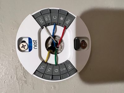

Been using my my Nest Learning Thermostat for 3 years with no issues. Once it updated to 6.2-27, it turns the fan off too soon but the compressor keeps running as it's not completed with it's cycle.  Tried another Learning Thermostat from my work that was on the same version and did the same thing in cooling mode.  Wonder if there is a bug with this version.  Even swapped the control board thinking that it was it since the voltage zeros out to the blower.  It doesn't happen if the yellow and red are hot wired together or when I connect my old basic thermostat.  Wish I could roll back the update to troubleshoot.

You state that if you touch Y to R, then let it run for say 10 minutes, then remove Y from R, the blower stops at the same time?  If this is the case, the HVAC control board controls the blower Fan.  Try this test, remove the wire in the G terminal on the nest backplate.  Then run your cooling test again.  See if the blower runs till the compressor shuts down.

It has the outdoor compressor and indoor standard furnace.  It is gas.  The blower is what I am referring to that is stopping and not circulating air.  The model is a C33-30A-2F.  I replaced the control board because I originally though I cleared the thermostat by having a voltmeter inline on the green wire.  When the blower would stop, the voltage was present.  So then I hard wired the red and yellow and used the switch on the furnace to turn on and off.  The blower always worked until I shut off the unit.  I found my old original thermostat and reconnected, and don't have any issues.  Before going out and purchasing a new Nest, I then borrowed the one at work that is the same model and it just updated the software.  I was able to narrow it down to just happening with both Nest Thermostats.  I had the Nest for 3 year with no issues.  It was using power sharing on 4 wires.  I was going to replaced the cable with a 5 wire so that the C lead can power the thermostat but can't pull the cable as it is stapled inside the wall.  The basement just got finished and in order to fish another cable, I would have to cut a hole in the ceiling and drill a new hole to fish a cable.  I guess I could connect the cable at the control board and the Nest thermostat to clear the C wire power.  Nest support claims it is because of the C wire but it worked for 3 years with power sharing.  Again, the issue only happens on cooling and not the heat.  I just don't trust leaving the Nest connected when I'm not home because the unit will freeze up with the blower turning off and the cycle not completed still running the compressor.
So the current cable has 5 conductor wires.  So, 1) R, 2)C, 3)G, 4)Y, 5)W.  The control boards in these systems either work or they are failed completely.  External to the control board is the 40VA transformer.
The 120VAC or 240VAC line voltage is connected to the primary side of the transformer and the secondary powers the control board and sends 24VAC to the thermostat.  First, turn off the power to the air handler.  Use a volt meter to confirm there is no power between Line 1 and ground, and Line 2 and ground.
locate the cover on the air handler where to power and thermostat wires enter.  Remove this cover and you should see the blower, the control board and the transformer.  Look at the thermostat wire, is one of the conductors not connected? If so, this will become your common wire.
You can find this in the air handler where the thermostat cable is terminated.  Follow the red wire towards the control board and locate where is connects with the secondary side of the transformer.  The common will be the second pole of the secondary side.  Simply connect the unused wire the secondary side somewhere and you now have common at the thermostat.  The common is used throughout the air handler.  I hope this helps.
 Before you turn the power back on, remove the C-Wire Modules, and connect the common wire color conductor in the air handler to the C terminal in the nest backplate. Then, go back and turn the power back on.
Unfortunately, the current cable has 4 wires.  It was using power sharing with no issues for 3 year to charge the thermostat.  I was going to replace it with a 5 wire but not able to run without cutting out the basement finished ceiling.  I provided the wrong model number earlier.  The furnace model is G40UH-36A-070-02.
