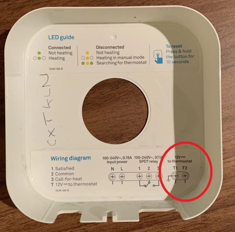

There is much confusion over the supply voltage for the nest thermostat. I have a UK 3rd generation learning thermostat. The heat link supplies 12V DC, the Google nest website says the supply to the thermostat should be 24V AC and the USB connection is 5V DC. I connected a 24V AC supply which made the thermostat run hot and gave incorrect temperatures. I cannot supply it from the heat link because of cable issues so can you confirm what the correct supply voltage should be? I wish to wall mount my thermostat but have no idea what the supply should be.
I have never seen any information about a UK thermostat running at 24v AC, the Heat Link clearly states 12v also inside the cover.
Yes it can use a usb connection as you state at the base ring for wireless connections, but for 24v I have never seen that.
Can you show where that information about the 24v for a UK thermostat?

Thank you for the input @Frustratedddd, you are on point. The Heat Link does indeed only offer 12 V DC to the thermostat.
To clarify, the US version of the thermostat is the one that runs off 24 V AC. The US one does not have a Heat Link and the base of the thermostat is connected directly to the system.
The UK, and EU, versions have the Heat Link unit. The Heat Link is connected to high voltage 240-220 V AC and provides 12 V DC over the T1, T2 terminals to the T1, T2 terminals on the thermostat base. So the thermostat base can be either connected to the Heat Link for power or using a micro USB cable and a power adapter, like when you put it on a stand.
So you may see on some sites that 24 V AC may be mentioned, but that is only for the US version of the thermostat.
I can understand where pyrmont25 is coming from as the internet covers mainly USA thermostats. Even on here, it's very difficult to work out which system is being used by the person posting the problem. You should have a section for UK/Europe and one for USA, then perhaps users could post in the correct location.
Having said that, the UK install manual and Heat Link, clearly states 12v for thermostat display. The obvious get out clause by Google at the top of the install manual is: ''The Nest Learning Thermostat for the UK and Ireland should be installed by a professional''

That is correct, we recommend the 3rd Generation be installed by a professional. This is not so much related to the display, as that is only 12 V DC, but the Heat Link, where you will be working with high voltages. Also, identifying the correct valves, terminals and other elements in the system can be tricky depending on the system at the location. We have the Google Nest E version that is recommended for a DIY option.
