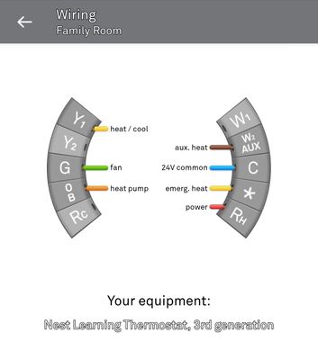

I have a nest learning 3rd gen and have the yellow to y1, green to g, orange to ob, red to rh, im not sure where to hookup the white , blue (old c wire), and a black wire which was twisted together with the black and hooked into the w2/aux on the old honey well. My system is a electric heat pump. Any help would be nice. Thanks.

If you have a electric heat pump with emergency heat hook up the wires as follows. I ran the test with all of the functions and everything works.
Hope this helps.

11-11-2023 11:48 AM
So where did you connected the black
11-11-2023 12:52 PM
So my black wire ended up being my emergency heat and connected it to the * (asterisk)
11-11-2023 12:53 PM
11-11-2023 12:54 PM
My W2/Aux wire is actually white and my emergency heat wire is black
