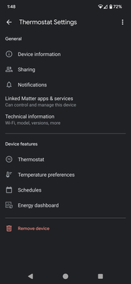

  here is the settings screens

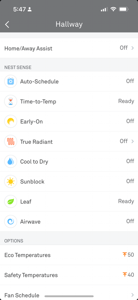

I turned off the Home and Away feature using the Nest App.  I open the Nest app, I select the my thermostat and then tap the settings gear in the upper right corner.  From there scroll down to Home and Away, change it to OFF.

 Here are my settings screenshot. So where is Home and Away exactly?
I do not recognize your screen, that is not the Nest App, perhaps you are using Google Home app?

@Thll ,here is the screenshot of my Nest App and my Nest Learning Thermostat, 3rd Generation.
