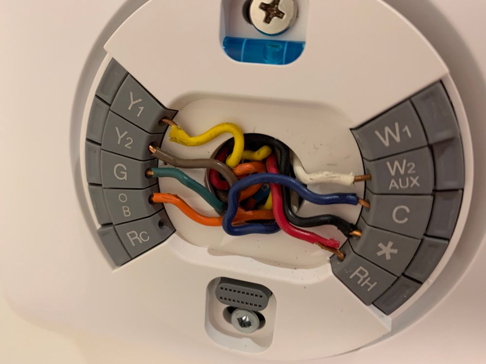

Here is the wiring, copied from our previous Gen2 installation.Skype_Picture_2025_02_02T03_43_24_280Z.jpg.jpeg
royjonker
Looking at it again, no idea why the white wire is in W2. ??
Hi royjonker,
Thank you for your response. And for sharing with us the photograph of your current wiring in your system, I will try to help you in the best way.
Okay, let's try adjusting those cables. Please connect the white cable to the W1 port and the yellow cable to the W2 port. Once that's done, turn your thermostat back on and see if the issue is resolved. Let me know what happens!

Hi. This change causes an error message. 'Y1 wire not detected. Heat Pump requires a Y1'.
Hi royjonker,
Thank you for your response. I will try to help you in the best way.
Thank you very much for your reply. The next thing we will do is return the yellow cable to Y1, and the only one we will change now will be the brown cable that is in Y2. We will move that one to port W2, and the white one should always be in W1. Let me know if you get any errors, and I will continue to help you.

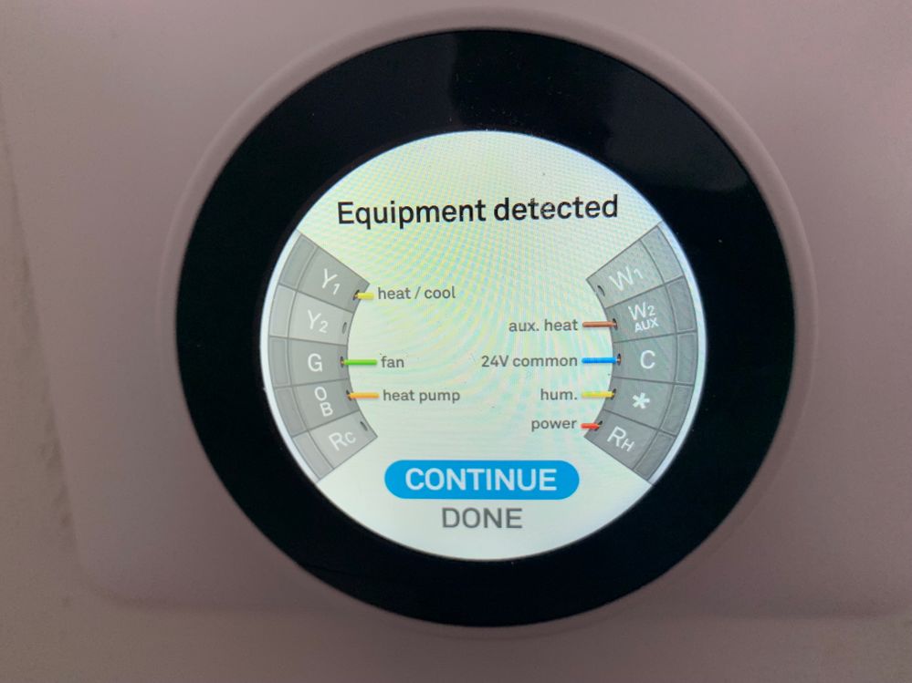

One question though: when the thermostat show Equipment Detected, it never show the white wire (currently in W1). Could this simply be my problem?Skype_Picture_2025_02_05T20_44_29_500Z.jpeg

In the Equipment detected photo, the humidifier wire is yellow (so, two yellows). Weird question maybe, but any chance that yellow and black wires got swapped somehow?

As you can see in the last photo, the white wire in W1 was not detected. I reinserted it properly. It now shows up, but I get the message 'can only have one Aux. wire'. So, it looks like having both white in W1 <and> brown in W2 is too much.
