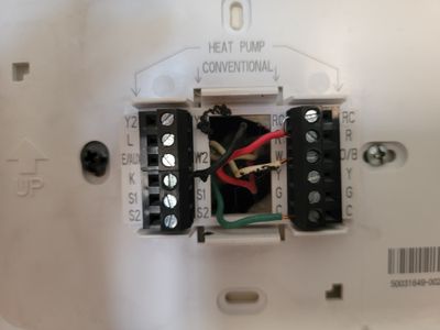

Hi,
I am using the honewell peaksaver PLUS thermostat and would like to replace with Nest Learning Thermostat.
The old one get wire for K, R,W and C.
I cannot find K wire for Nedt Learning.
And should R to Rc, W to W1?
How should it map with Nest Learning Thermostat? Thanks
Houptee
There is a Honeywell box at your furnace that is similar to a Nest power adapter that simulates a C wire when you do not have enough wires to connect a real C wire.
So you would remove that little Honeywell box at the furnace and either run a new 8 conductor thermostat wire to the Nest and use blue for a C wire,  or leave the old wire and the Nest Learning might be ok without a C wire if it does not give any power errors it should be fine. If not then you would need to use a Nest power adapter to simulate a C wire.
So if you want to try using the old wires first get rid of that Honeywell box and put the old wires directly to the furnace terminals R, W, Y, G (use black for Y)  then do the same at the Nest and see it it works without a C wire.

nickwoo
Thanks, I connect the black wire to Y1 and it works now. Thanks for the reply.
