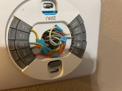

Micah_S
Hopefully this will help with a solution for someone else:
