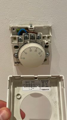

I currently have the system below (with a 2-wire thermostat) and I'd like to upgrade to Google NEST 3 to manage the heating (but not the hot water).
On the white connection bar, LN is connected to the power supply, and pins 3 and 4 are connected to the 2-wire thermostat.
After a lot of research, I've deduced that I'll have to connect the whole system as shown below, is that OK?
