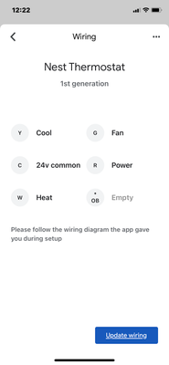

If you have plugged a wire to the OB, you need to set the setting of that wire. Tap the OB and define its function.
This is what I’ve got.  

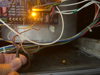

You have a 2-stage heating system and the Brown wire is connected to W2 in your furnace control board.  You need to define the O/B as state 2 Heat.
thank you for your help!
