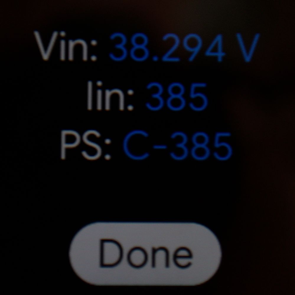

01-18-2023 03:47 PM
It says the voltage is 38, which seems a little high. It *IS* wired to the "C" terminal on my FAU. It is a Trane XR90 propane heater.
01-19-2023 11:48 AM
Thanks for sharing the pictures with your thermostat's diagram and power status. Let's sort this out.
Have there been numerous power outages while you've been using it? The batteries in the thermostat will keep it running in the event of a power outage. The battery life is shortened when it only receives power from the batteries and not from any of the power wires.
Please check the battery health in its settings. If the battery health is higher than 1500 milliohms, remove the batteries and clean the contacts. Then, check if there are changes. If the readouts are still the same, replacing the batteries would be the best option. Have a look at this article and let us know if you need more help.
