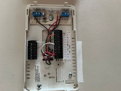

I am replacing a White-Rodgers 1F95-391 with a 4th gen Nest thermostat and have a white wire connected to an OT terminal that does not show up in the compatibility checker.
I have C, R, E/W1, Y1, O, G and OT
oil forced air and heat pump (separate Life Breath air exchanger).
Thanks

Mark_M
I also have a white wire connected to a OT terminal. Thoughts on where that would connect?
Rusell
Hi Mark_M
Thank you for your response. It is advisable not to connect the white wire OT terminal to the current Nest Thermostat.
For further assistance, to help us get a better picture of what's happening, do you mind sharing a photo of the wiring of your old thermostat?
keep me posted.
Rusell
Mark_M
I was 'banned from the site on my phone.????
How do I upload a picture?

Mark_M
 The OT terminal and white wire are on the upper strip.
Rusell
Hi Mark_M,
Thank you for the update. I appreciate the information provided but we still need to move forward with regards to your concern therefore i'd like to ask you a few questions below:
  • Is there a jumper between R and E2?
  • Is your system dual fuel?
Keep me posted.
Rusell.
