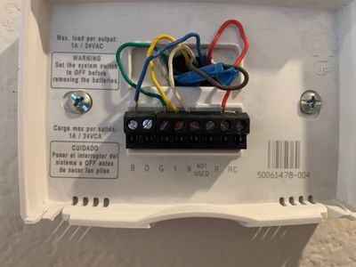

Wire compability check if I can install a nest 4th gen thermostat?
@RenatoVillard ,
You will have no problem replacing the old thermostat with a Nest. The blue wire on B is your Common.

@RenatoVillard ,
please upload a picture of your old thermostat baseplate so I can see the wires attached and thier insulation colors.

@RenatoVillard ,
