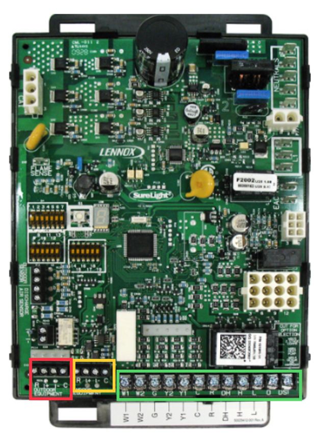

@emcgee , this what the iComfort Communicating control board in your Lennox furnace looks like.
if you have wires connected in the red box area above, that means your outdoor unit is also an iComfort, communicating unit. Your current thermostat is connected to the terminals in the yellow box above. Can you go outside and get me the model number of the Lennox unit?

That unit also has a very intelligent control board so it’s possible they’re using the  iComfort control on the outdoor unit as well.  That would mean that would probably have to rewire that unit. In addition to the thermostat cable might have to be upgraded on both ends.
