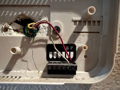

help me please with Nest learning thermostat connection. I only have 2 wired
Chimz
Can someone help me how to connect this to my old thermostat wiring
Jhonleanmel
Hi Chimz,
Thanks for posting. Based on the photo you sent, this is an incompatible system with the Nest Learning Thermostat. You can check this guide for more details: Nest Thermostat compatibility
Mel
Chimz
Thanks…I hired an HVAC guy to come and fix it. NV Energy installed a device where they can control my heating and cooling. That has been disconnected and NEST LEARNING THERMOSTAT is working perfectly now. Thanks
