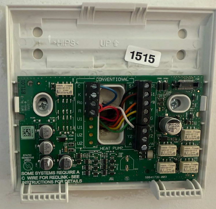

I am hoping to replace honeywell thermostat with 8 wiring with Nest 3rd generation. I have heat pump with duel fuel (electric and propane). can someone advise on wiring please - where each color wiring will go with nest. thanks
04-02-2025 11:41 PM
Give this wiring a try.
Blue - C to C
Red - R to Rc (jumper to Rc not needed)
Black - S1 -tape off, not used
Brown - S1 - Tape off, not used
Orange - O/B to OB
Yellow - Y to Y1
Green - G to G
White - AUX/E to W2/AUX (set as Aux heat)
