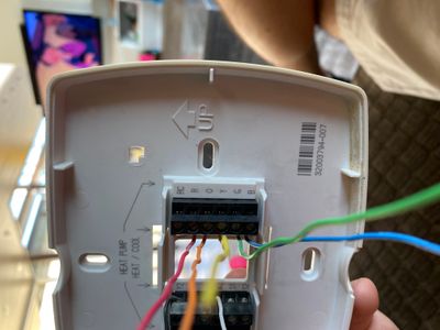

w1 and w2 are tied up together on 1 wire on the furnace board. how do i manage the cables on the thermostat. I've attached pictures of how I've had it set up right now. and I'm sure I have 2 stage heating

It's obvious that your previous thermostat and your thermostat wiring did not support 2 stage heating even though your furnace controller board does.  W1=Stage 1, and W2=Stage 2.  Your thermostat wiring only has 5 wires.  In order to support 2 stage heating, you'll need to replace your thermostat wire with a 6 wire bundle instead.  You would then remove the jumper between W1 and W2 and run separate connections to W1 and W2 on the Nest and W1 and W2 on the furnace.  These wiring packages are readily available at Home Depot, etc.  It's not very hard to pull the new wire through.  The wires are not usually stapled inside the wall cavity.
