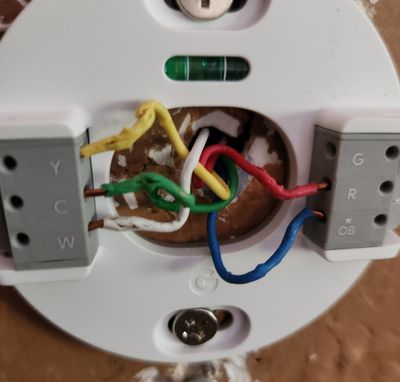

kupper
 this is the nest side
Houptee
I dont even see the white wire from the thermostat in the control board pic.  Can you take a better pic of the control board with the wires clearly shown what screws they are on. It is hard to tell from that picture.
And do you know if this is a Heat Pump because they have blue wire in the Nest OB and that is only used for a heat pump system.
Who wired the Nest and the control board? Was it a professional HVAC company or did you self install it?
kupper
The white wire goes to w1. It was wired like this when we moved into the house few years ago. This is a normal gas furnace with outside ac unit.

Check the white wire is firmly in the Nest terminal as that is W1 heat control wire that turns on your heat when the Nest sends out + 24 volts on the white wire to the control board.
Also check the W1 screw is tight on the white wire on the control board and no wires are touching each other making a short circuit.
You must have 2 stage heating and they used the OB wire and it goes to W2 (2nd stage heating) on control board.
Do you still have a picture of the original thermostat's wiring? If you do, can you post it here?
