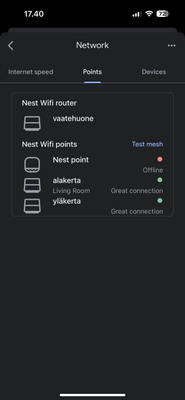

Thanks David, I did check this troubleshooting, but it doesn't seem to be due to issues with ios. The Nest Wifi does manage to connect to the network, but then "disconnects" while finalizing things. After this I can see it as one of the "wifi points" in the Google home app, but it is offline... what's weird that I don't have issues getting any other devices onto the network.

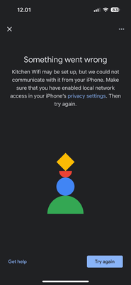

This is what it keeps doing all the time.  After finding the device, scanning the QR code, it shows "connecting to Wi-Fi". Then after a while it shows connected, and immediately after that "something is wrong".
the app has all the permissions it should have, I uninstalled the app & reinstalled (and after that it readded my LG sound bar onto the network with no issues). Everything is working fine, but the Nest Wifi just will not get onto the network.

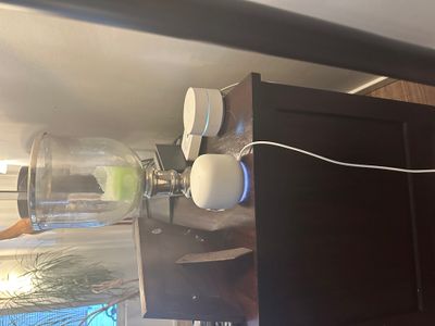

They are broadcasting SSID on the two visible networks (aka Google-Wifi and Google-Wifi-Guest, I know, named really intuitively... )The Three old points are showing this light blue light, see image.

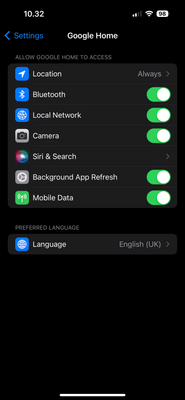

Just tried doing the connection with my iPad, but still hunting for an Android device to try that as well. The result of trying with the iPad was the same as with the other devices, I get all the way to the point where I scan the QR code, but after that the connection fails. All permissions are given to the app.

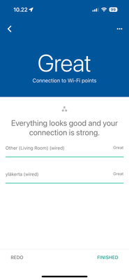

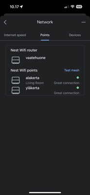

Just ran the network test & mesh test (with the old Google Wifi app, as personally I still find it better). See screenshots attached.

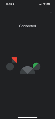

This is the furthest I have been able to get. This has happened a few times, when I have been next to the wifi point that is designated the router.  But there doesn't seem to be any way, I could get the nest point to turn to "online" after this. And there doesn't seem to be any proper troubleshooting tools available (like checking the SSID setup on the device etc...)

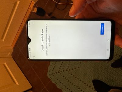

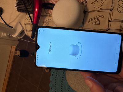

After a painful and tedious process I managed to get one old Android phone working. (it was locked, and using a google family link account which caused me to try to unlock it with wrong accounts etc...) But finally it relented... to no avail. The same issue persists. I get all they way to the "final step" i.e. adding the wifi point to the mesh network, and then nothing. (see images below.  The ui was set to finnish, so you might not undertstand the prompts.
