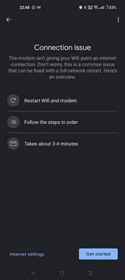

We appreciate your update. Could you send a screenshot of the message that you're getting whenever you try to set up your network?
