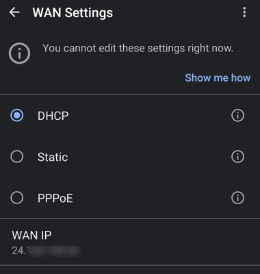

tech_fatigue
Hi Byron,
My google wifi WAN ip is not an local address. The upstream router is already in bridge mode.
Thank you
ByronP
Hi tech_fatigue,
Thank you for your response and the detailed picture.
Based on your information provided, please do the following:
Please confirm if you're able to access the service locally.
If so, then there may be an upstream router that blocks the packets or the service isn’t configured properly for external connections.
