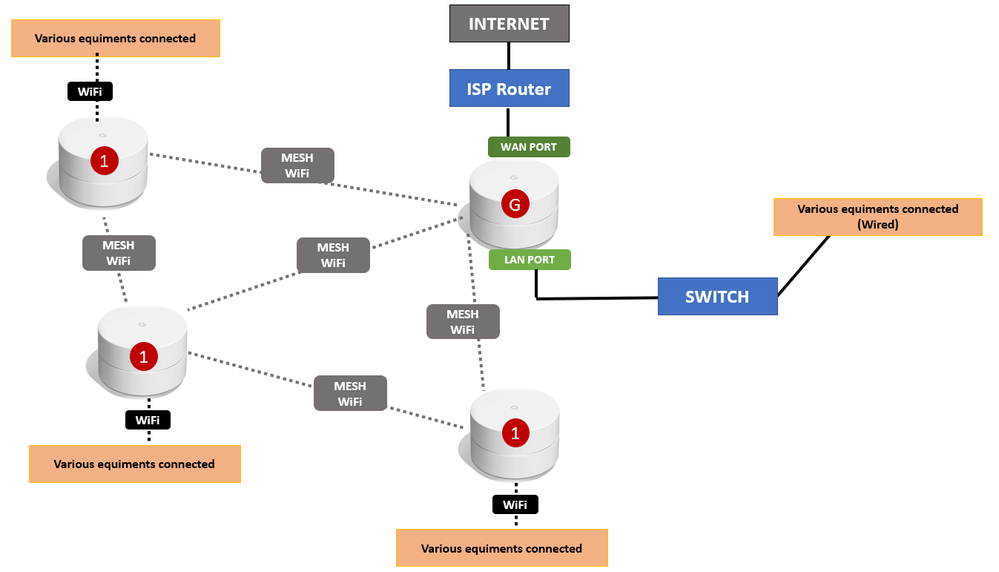

Being a Google Wifi user (First generation) I have a setup that looks like this picture:
The important thing is:
- The Wifi network is totally independent of the wired network, to avoid any loops or routing problems.
- Of course, the Google Wifi Gateway is connected via the LAN to the wired network and via the Wan to the Internet BOX.
Everything works fine, but sometimes I have big drops in throughput, going from 500 Mb/s to 20 Mb/s, and this drop in throughput also affects equipment connected via the wired network. I've been able to diagnose that the throughput problem comes from the Google Wifi Gateway, because:
- If I connect directly to the box, the throughput is good, so it's not coming from the box or the Internet connection itself.
- If I electrically reboot the Google Wifi Gateway, the problem is solved.
- If I restart the Wifi network (via the Google Home app), that solves the problem too.
Has anyone had this problem?
What can I do to make the flow stable?
Is there a function that would allow me to diagnose the gateway itself?
Thanks in advance!
Sylvain

Hello, these are some answers  additional infos.
  • When did the issue start?  => From the beginning with my new Internet connection - my first ADSL was so bad i didn't noticed it... But now, with the Fiber  I can't see it clearly
  • Have you tried checking the internet speed without the Switch? => I don't use any switch between the Google router and the Internet Fiber box, it is directly connected - If you're talking about the switch between my PC and the Google router, yes, because I notice the same drop in speed if I'm on Wifi.
  • What happens if you only use Wi-Fi and remove the switch from the connection? => The same behavior (see up)
  • Are the devices connected with ethernet also affected?  YES
  • What color is the Led light when you lose the connection? - I don't "lose" the connection, it is the bandwith which is falling
Additional information: I did a few more tests. When I have the bandwith drop, I've tried restarting some equipment to see if that brings the bandwith back to normal: nothing helps.
EXCEPT: If I go into the Google Home app and ask for a network test, the bandwith immediately returns to the right level - the problem is quite localized at the Google Router level.
regards, Sylvain
