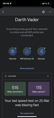

Just did a factory reset of my Google Wi-Fi routers (3 set). Everything was running smoothly before (though they were interfering w/ a device).  They are and were all connected to the Ethernet network of the house but are out of range for mesh/ weak connection. In spite of this the old setup worked as devices reconnected to the available Wi-Fi signal in each floor. Now the pucks out of range just don’t emit Wi-Fi signal. What can I do?
in the app it’s all seemingly ok but the mesh strength signal.
