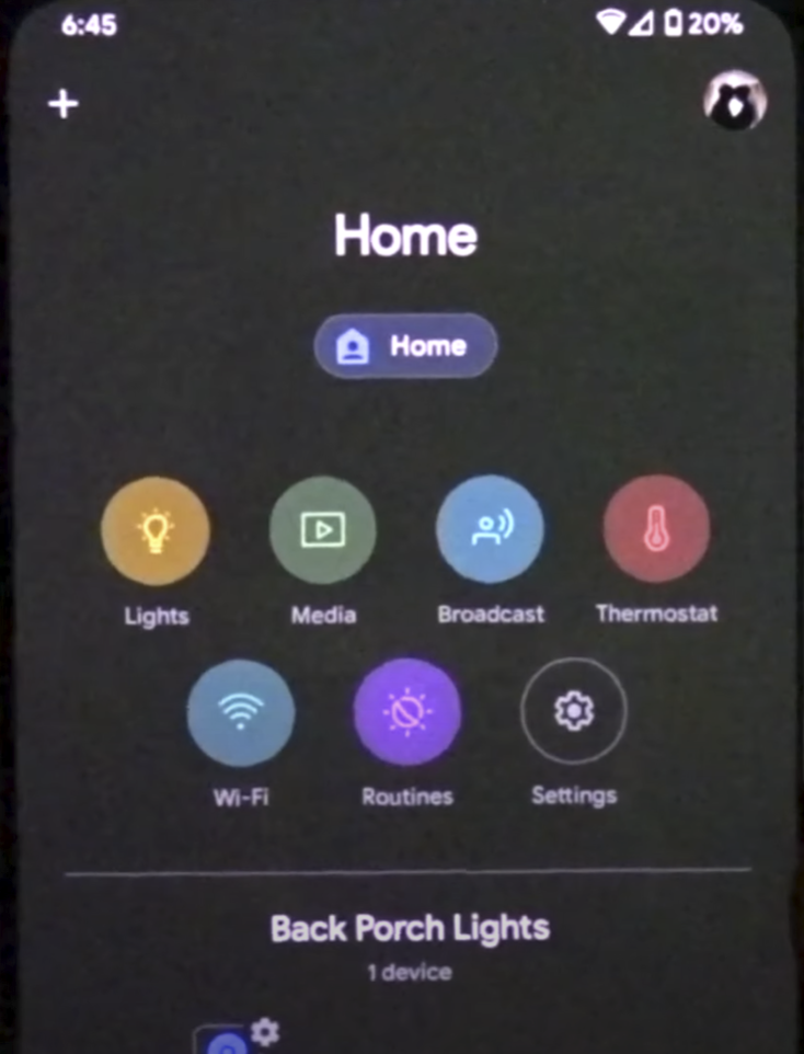

One thing I noticed is that in my Google Home app, I don't have "Wifi" up top, just Lights, Media, Broadcast, Thermostat, and Routines.
At bottom under "Local Devices," just my one original point shows up. The screenshot below is the UI of the phone from the guy I was following on YouTube for my instructions, and you see his "wifi" at top -- I don't have this. Maybe that's why my app wants to set this up as a net router, it somehow doesn't recognize the original one? Which would be weird because I set it up on this phone originally.
It seems like I'm not the only one who has had this issue (see here: https://www.googlenestcommunity.com/t5/Nest-Wifi/WiFi-icon-is-not-showing-up-on-Google-Home-app/m-p/...
I feel like it may have something to do with this. I'll try the steps you mentioned on someone else's phone. Thanks
