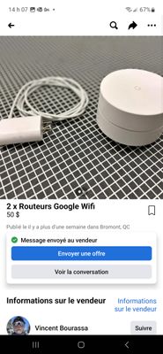

Ok so i could use "old gen" google wifi points since they have ethernet ports
But i plug it in the switch but dont plug an ethernet cable "out" of the wifi point
That what i was about to do but i ve asked myself if it was better to continue with nest hardware     but you confirmed that i could use standard google wifi point so im happy about that
When you say to plug the wifi points  at the edge of the switch    do you literaly mean the edge of the switch hardware    or u mean to not continue the "wired" network from the google wifi point to another hardware?
Cause i have a switch beside my main router in the basement..from there   ethernet cables go to 1st and 2nd floor.
On 1st floor i have another switch that i plug the ethernet cable that comes from the basement..and the other ethernet that i plugged in that switch goes to tv, videogame consoles, pc     (so would that be ok that my last availablr port on thsr switch on the first floor..i plug a wifi google point to expend my 1st floor wifi)
And same configuration on the 2nd floor since from the 2nd floor switch  the cables go in 4 rooms      and u would take one port for a 2nd wifi google points to expend wifi on 2nd floor
Is it clear what im trying to explain?  Lol
    so that would work just fine?
