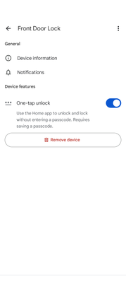

I just installed a Yale Smart Lock with Matter. I have enabled One-Tap Unlock in the Home app, but the passcode is not saved. Every time I tap, I'm asked to enable One-Tap again and enter the pin.

I just bought this lock. Trying to add a simple passcode to open the door. The Yale app warns me to use the Google Home app because, if I register with Yale first, I can't use it with Matter. But then when I add lock to the Google Home app, it doesn't have a way to add codes. What should I do?
sinanju
Find the lock in the Home app and tap it. Then tap the gear icon. In the settings, select Household & Access. Tap on the person for whom you would like to set a PIN. At the bottom you will see an option to set a passcode
JCinadr
Thanks for the quick reply! But I don't see that option when I click the gear icon. All I see is Device Information, Notifications, and One-Tap.
sinanju
Have you added the lock to your home in the Home app and placed it in a room?
See if it is unassigned in the Devices tab.
