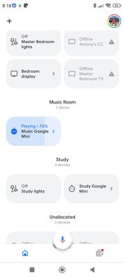

12-01-2022 12:50 AM
Hi
For my device called "Music Google Mini"
If I issue the command "play xxxxx on Music Google Mini" followed by "stop playing music on Music Google Mini" via the app, the "stop" command DOES completely stop the music.
