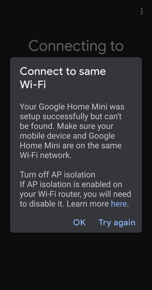

I appreciate all the answers I've gotten for my first post about the issues I'm having with my Google Mini. But I'm still having issues. When I reboot the mini and start from the very beginning of setting it up, I'm able to get this far (See Attachment Below).
Based on the attachment’s response, I needed to turn off AP isolation on my router. I have an Altice One cable Box; it has a 2-in-1 router (both a modem and a Wi-Fi router). I remoted into the router and didn't see the AP isolation option. I then reached out to my Cable provider about the router, and asked is it called something else. And they confirmed, the router doesn't have that option. Then said, when you’re setting up the Mini when I see the message "do you want to allow this device to communicate with other devices on this network" I have to say yes.
That seemed like good advice, but I'm never asked that when I'm setting up the Mini. I've tried installing once a day every day since our last interaction on 07/09/23, and I can't get any further than the attachment. I also tried adding my two Chromecasts to my Google Home. The Chromecast / TV in the Living Room is about 5 feet from the Google Mini, and it gave me the same error as below and so did the Chromecast I have in my Bedroom. The crazy thing is, all three worked flawlessly until I added my Nest Gen2 Doorbell. Since the doorbell wasn’t adding, I took the advice from the community deleted my Google Home and recreated it. And yes, I was finally able to add the doorbell to my home but can’t add the three google devices.
So, my question is, how do I get passed this, if my router doesn't have the AP isolation option to disable? Please advise.

Apologies for not getting back to you sooner, I checked my router, and all the setting you said to enable: Universal Plug and Play (UPnP), multicast, Internet Group Management Protocol (IGMP) were already enabled. These were already disabled: AP/client isolation, virtual private networks (VPNs), proxy servers, IGMP Proxy. My router doesn't have the AP/client isolation option. And that's the error that appears every time I attempt to add my Google Mini and my two Chromecast's. The weird thing about all of this is, all three were working without issue, until I deleted my Google Home to add the Google Nest Doorbell.

Thanks for the information. Last night I did as you suggested, and I got the same error as above. Very frustrating since the only reason I'm in this situation was due to deleting the Home and recreating it to add the Doorbell.
