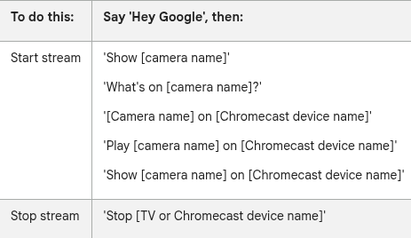

  • Below you'll find a table to use Google Assistance's voice commands to stream your Tapo camera to your Chromecast with Google TV (4K):
Byron
