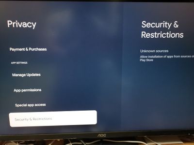

pangziabei
I have just bought my 3rd Chromecast w/Gtv.  I found I cannot enable installing apk from unknown resources on the new device (that I can do it in my previous 2). While I was setting up the device, the menu "Security and restriction" suddenly  replaced by another "Security" menu...
Original:
 After a minutes:
IMG_20230128_015225.jpg I have factory reset the device few time and get the same problem.
Can anyone a advise? thanks a lot.
Hi @pangziabei
You have to enable Development Mode first to allow Unknown Sources.
On your Chromecast, open the side menu and go to Settings > System > About. Scroll down to the Android TV OS build section and click that repeatedly. Go back to the main Settings page and select Apps > Security & Restrictions > Unknown sources.
Hope this helps.
