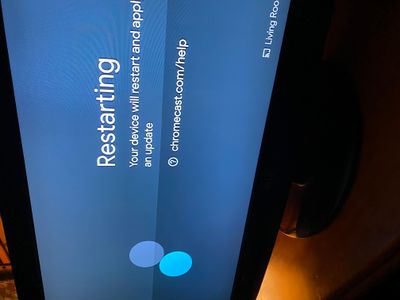

Thank you again for your patience, we have some good news - the fix should reach all users today. If your device has received the update it should be on the following firmware versions:
Chromecast (2nd gen): Firmware version 1.56.467165
Chromecast Audio: Firmware version 1.56.467166
Check the firmware version of your device by following the instructions here. If your device is not on the corresponding firmware version, please try rebooting your device to start the update process.

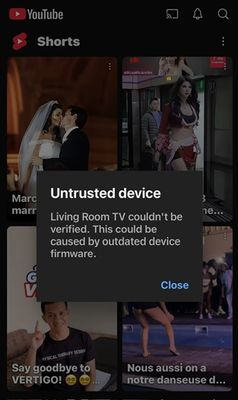

Hello,
We're aware of an emerging issue impacting Chromecast 2nd gen and Chromecast Audio devices, and we are working on a fix.
Do not factory reset your device - we will keep you all updated when the fix rolls out. If you have already factory reset your device, we will provide instructions to set your device back up as soon as possible.

It works again!!!! Im from Germany...I did a reset (Chromecast 2) and nothing works anymore...so i put the date of my mobilephone  ( Android) to the 05.03.2025 and i could conected my Chromecast. Of course i put the date Back correctly...But it said since this morning, not the same Wifi...Now, all works.

The Chromecast-update just came though!
It will update automatically...
