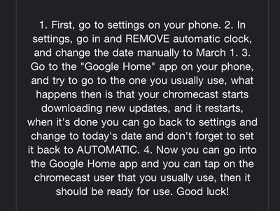

johnnyzero2
For all the people who performed a factory reset during their initial troubleshooting, this procedure will allow you to reconnect your Chromecast to your Wi-Fi network, so that it can receive the firmware update fix that Google started rolling out on 3/13.
1) Temporarily set the date on your smartphone (or tablet) to March 7, 2025 or earlier. If you don't know how to do that, see below.*
2) Use the Google Home app to re-setup your Chromecast by adding it as a new device (+). You still won't be able to cast, and the device will be grayed out in the Home app, but that's ok. Most importantly, it'll now be reconnected to your Wi-Fi network so that it can receive the firmware update fix.
3) Change your phone's date/time setting back to Auto now.
4) Sit back and wait for the firmware update from Google to be installed. This should restore your Chromecast to full functionality.
Note: Supposedly it's being done as a "phased rollout", so it could take a while for the firmware update to hit your Chromecast. Also, some have reported that power-cycling your Chromecast (unplug/re-plug the power cable) will sort of "provoke" the firmware update to be installed. Patience.
*How to change your phone's date/time settings:
For iPhone/iPad: go to Settings, General, Date & Time. Disable "Auto" and manually set the date to March 7, 2025 or earlier.
For most Android phones/tablets: Settings, General Management, Date and Time. Disable "Auto" and manually set the date to March 7, 2025 or earlier.
**Google REALLY should pin this information to the top of this page!**
Niklas2323
1. First, go to settings on your phone. 2. In settings, go in and REMOVE automatic clock, and change the date manually to March 1. 3. Go to the "Google Home" app on your phone, and try to go to the one you usually use, what happens then is that your chromecast starts downloading new updates, and it restarts, when it's done you can go back to settings and change to today's date and don't forget to set it back to AUTOMATIC. 4. Now you can go into the Google Home app and you can tap on the chromecast user that you usually use, then it should be ready for use. Good luck!
