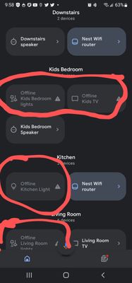

Hey,
I have a smart switch linked to my account through GE Cync, that I no longer have access to physically. I unlinked it from my GE account but it still stays linked to my Google account. I’ve tried to move it to a different Home and deleted that home, but it reappears under my current Home as a ‘Device linked to me but not in home’.

I'm having the same issue but with MULTIPLE devices. This all started when I invited my wife to help manage my Home. Things were not working right so I booted her from my Home. ALL my devices that are linked via Works with Google stop working. I tried to link them back but nothing gets added and i have many devices that are linked to me but disconnected. When i go into the device and try to unlink it, it takes me to Works with Google page to link the devices again (TP-Link, Wemo, etc.) I tried deleting the Home, removing the application, even factory reset my device. NOTHING works! All my devices that are added via "Works with Google" DOES NOT work with google. I can still control all these devices via their own apps (Wemo, Kasa, etc.) but unable to use them in google home, i just get a disconnected icon on my home deck.

Yeah, thing is, cannot remove a product that Google thinks isn't there.  These don't have a "remove" option.  They must've added that in a later update but older setups don't have that.
The only workaround I've been able to find is to create an entirely separate "home" for these ghost offline devices, move them there and make sure to leave the new home intact as it's meant to essentially trap the offline devices and keep them out of your main home.  It's definitely a workaround and not what I'd like to be doing but it's the only thing that worked.  You cannot delete the additional home though, otherwise the ghost devices go right back under "linked to you".

  • When I unlink the ghost device service (SmartLife in my case) they are still in my Google Home app.
  • When I relink the ghost device service, the devices are still offline, and the service reappears on that website.

Thank you for the suggestion but this did not work for me. Even though I clicked 'unlink' following your instructions, my ghost devices still show as 'offline' in the Google Home App.

For me, this started when I added a new device.  I'd had no issues prior to adding the 2nd generation Nest Hub and afterwards nothing wanted to work right.  It was a total nightmare.  I've never had another member of my "home".  Just myself and adding that new device was the only change I'd made recently.  I don't think this error cares what change you've made, but rather simply that a change was made and the result is the sync error.
chanson
UPDATE: Your post gave me the idea to try link my 3rd party account to her Google Home account. From there I was able to add the devices to our home (and moved the duplicate ghost devices to another fake home). The ghost devices still exist for me, but now at least my Google Home responds with something other than "A device is offline".
