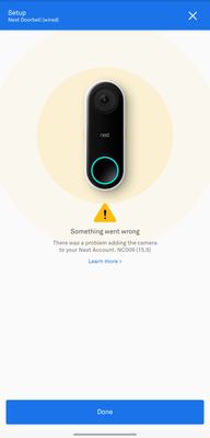

Such a stressful situation right now. I'm moving from one house to the next and re installed my door cam (nest hello) at the new place.  During the re setup I'm getting stuck with the NC009 error. Google says it's my internet, but I transfered my same exact modem from the old home to the new home as a plug and play.  I've done all the steps you can think of, mobile Hotspot to creating a new home in the nest app, also removing all security to my modem... I've probably factory reset this thing 25 times now with the same error. (Factory reset my modem a few times too! ) i'm lost for words right now and  advance tech support isn't really helpful.  All my other google/nest products are connected and no issues.
I can see the doorbell logged into my wifi st the 2.4 with a strong signal as well.
Has anyone have other ways of figuring this out?
