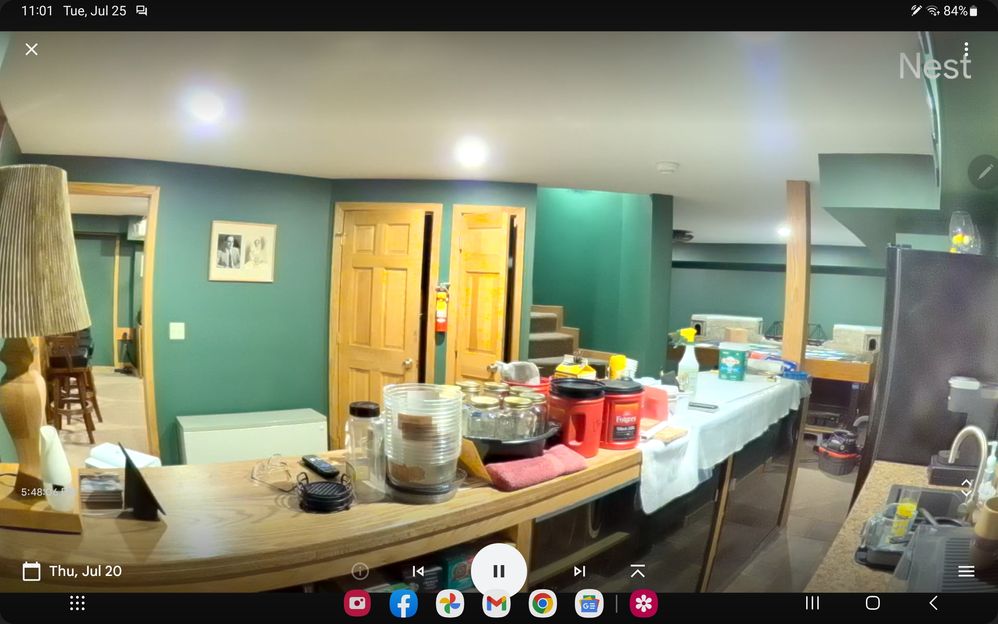

FYI next I will try to upload a photo from the camera when IR was manually turned off. Don't take his as the set orientation since I tried many.
Regards Bob
07-28-2023 07:32 AM
Part of my basement
