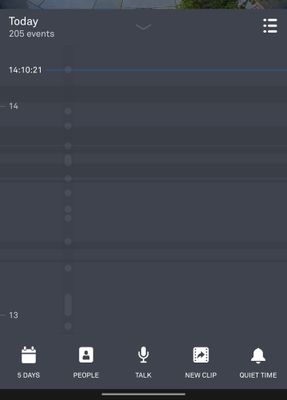

Hi, I've had my Nest Hello Wired since 2019 and not had any problems (apart from peeling). For the past few days though it has been mostly offline. It occasionally reconnects but only for a short period before it goes offline again. It rings the internal chime no problem and plays all the Winter theme sounds outside when the button is pressed no problem. My router is showing that the doorbell WiFi is connected and is getting good signal and I can change settings on the doorbell through the Nest app, no problem. In the Nest app timeline, there are light and dark bands which used to show when the doorbell was online or offline but these now make no sense as regardless of whether I scroll to a light band or a dark band it still says the camera was offline. I also get no notifications at all through my Google Home speakers of the doorbell being rung.

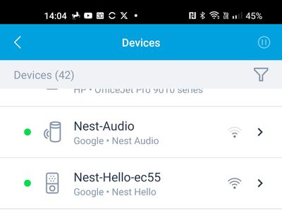

The doorbell has gone offline numerous times already today but never for more than 10 minutes so I wasn't notified by the Nest app. By chance I noticed that it was offline again a few minutes ago and I was able to view the status light surrounding the doorbell button - It looks white (in the daylight), but even while the doorbell was offline my Orbi mesh network was reporting that the doorbell had a very strong-maximum WiFi signal.
