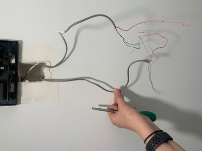

MG8
I took picture of the wires. The 2 blues are the ones I’m conecting to the connector.
. Hopefully I’m doing something dumb!! Hahahha
@MG8
I'm sorry, but I really can't tell what's being shown in your photo; I don't know what those two sets of 3 wires each was previously connected to.
