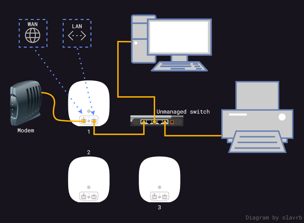

Sounds like a double NAT situation: Put the ISP equipment in bridge/bypass mode which also disables its' Wi-Fi. Only Nest Wifi should be used for Wi-Fi. Don't use the ISP ethernet ports for anything but the main/primary Nest Wifi unit. More on double NAT:
As mentioned you'd also use Nest Wifi for ethernet devices. Add an unmanaged switch if you need more ports:
It also sounds like too many Nest Wifi units too close, which hurts performance due to interference and unneccessary overhead (traffic going between the Nest Wifi units). More isn't neccessarily better. More on how many you need and placement:
